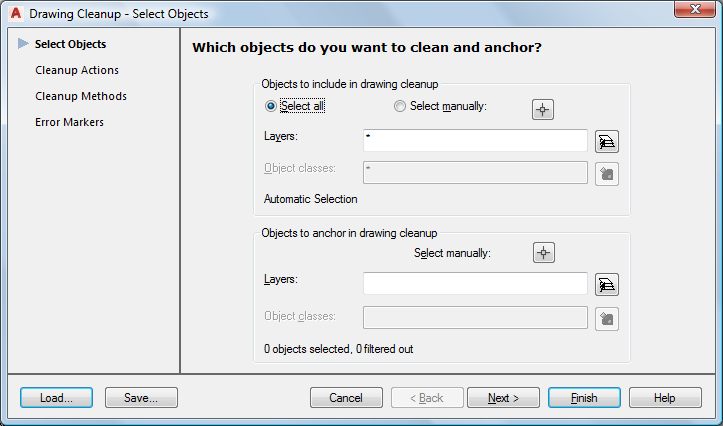

  3. In the Drawing Cleanup - Select Objects dialog box, do the following:
    • Under Objects to Include In Drawing Cleanup, choose Select All.
    • Make sure there is an asterisk (*) in the Layers box.
    • Click Next.
      Select all objects to include in the cleanup operation.
