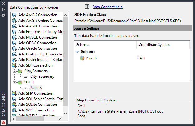

  2. In the build_map1.dwg file, in Display Manager , click DataConnect to Data.
  3. Under Data Connections By Provider, select Add SDF Connection.
  4. Click the file icon next to Source File.
  5. Navigate to the folder where you copied the sample files and select PARCELS.SDF. Click Open.
  6. Click Connect to add the parcel data file as a data source.
    Under Add Data To Map, Parcels is selected.
    The coordinate system for this feature class is displayed next to its name. If this information was incorrect, you could click Edit Coordinate Systems to change the coordinate system.
    Note: Change the incoming coordinate system only if you know the original coordinate system for the feature—do not change the coordinate system to match your map. AutoCAD Map 3D toolset automatically converts each feature from its own coordinate system into the coordinate system for the current map. If you change the coordinate system, the conversion might not be correct.
  7. Click Add To Map.
    In the Data Connect window, connect to a data provider and then select the feature class you want.
    When you click Add To Map, a layer called Parcels is displayed in the list in the Display Manager . A layer can be styled, saved, displayed, or hidden, independent of other layers in your map.
