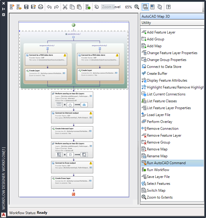

Activities in the workflow appear as a diagram in the Workflow Designer.
Utility and AutoCAD Map 3D Toolset Activities
The Activity panel on the right side of the Workflow Designer contains two categories of activities. AutoCAD Map 3D toolset activities are specific to AutoCAD Map 3D toolset (including an activity that runs AutoCAD commands).

Parallel and Sequence Activities
In a workflow, parallel activities are independent of one another. For example, when connecting to two data stores, parallel connections ensure that the second connection executes even if the first one fails.
A sequence activity depends on previous activities. For example, within the parallel activity at the top of the overlay workflow are two sets of sequence activities. Each one connects to a particular data store and then creates a layer for that data store. If the connection fails, the layer cannot be created.
