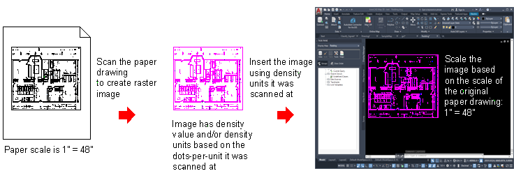

The following example shows the relationship between paper scale, density units, and insertion scale for an image that is not georeferenced (an image that was not saved with real-world unit data). Any image that is drawn using a scale (such as a floor plan) and captured with a scanner will likely fall into this category.
The image in the following example was drawn at a paper scale of 1" = 48", scanned at 300 dots per inch, then inserted into a drawing using 300 as the density value and Inches as the density unit. Then it was scaled based on its paper scale of 1" = 48".
The density units that you select when you insert an image that is not georeferenced should match the units at which the image was scanned. In this case, the units are inches because the image was scanned in dots per inch.
Remember that the scale must be based on the same units. For example, if the scale in the original floor plan is 1" = 4', you must convert both sides to the same unit. In this case, convert the 4 feet to inches, which is why you use 1" = 48" as the scale factor.

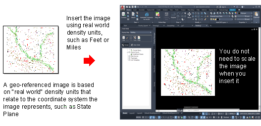

The following example shows the relationship between density units and a georeferenced image. Because there is no paper scale to consider, you can insert the image using the units that the image represents, such as feet or miles, and you do not have to scale the image when you insert it.
Georeferenced images include GeoSPOT and GeoTIFF file types, and images that use World files as their correlation source.
