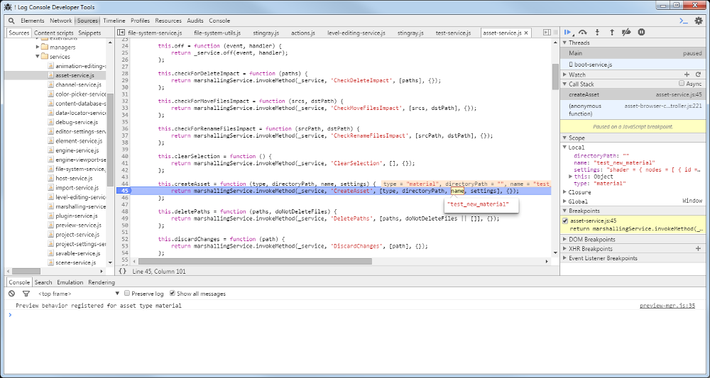

The editor's front-end HTML5 environment runs in the Chromium Embedded Framework (CEF). This means that you have access to the Chrome Developer Tools panel, which offers many essential development resources. You can use the DevTools to place breakpoints and debug your JavaScript code, explore the HTML of your panels, and run JavaScript commands in a console.
To launch the DevTools, press Ctrl+F12.
Each editor window gets its own instance of the DevTools. If you want to zero in on a particular panel, you can undock that panel into its own floating window and press Ctrl+F12 while that window has focus.
For details on all the capabilities of the DevTools, see its home page on the Google developer site.
