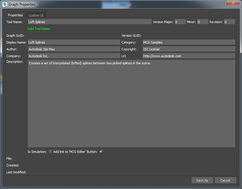

When you save a new tool (File > Save As...), you are prompted with the Graph Properties dialog. This dialog may also be accessed under Edit > Edit Graph Properties.... Changes made to this dialog are applied upon saving (by pressing Save As upon first save, or by pressing OK then CTRL+S if the graph was already saved once).
A tool name is valid if it does not conflict with any of the tool names which are currently loaded into 3ds Max. You will be presented with an error in the MAXScript Listener if the tool's name conflicts with a pre-existing tool.
Note: Redefining a tool's name may have unexpected consequences if the tool is active your scene. If you are modifying a tool's name, it is recommended you restart 3ds Max.
This value is ultimately responsible for defining the unique 3ds Max plugin class ID associated with this tool. Every MCG tool is registered into 3ds Max via the plugin system. When a new .maxtool file is saved for the first time (File > Save As...), the Graph GUID will be automatically generated. You may inspect this graph GUID by re-opening the Graph Properties dialog (Edit > Edit Graph Properties...) once the file has been saved.
Given the interactions with the 3ds Max plugin system, there are a few points to keep in mind when manipulating .maxtool files on your filesystem:
If you copy a .maxtool file and rename it, a duplicate message will be displayed in the MAXScript Listener if both these files exist in the MCG loading path on startup. Despite having a different filename, both files will contain the same Graph GUID. The highest version of a tool will be built if duplicate Graph GUIDS are found.
The Graph GUID may be modified manually by opening the .maxtool file in a text editor, and editing the guid attribute in the <graph_version guid="..." number="..."/> XML element. CAUTION: Modifying this value will break all the scenes which depend on this tool; the 3ds Max plugin classID is ultimately altered by modfying the Graph GUID.
Major, Minor: These fields may be incremented manually. We recommend Semantic Versioning for your tools and compounds.
Revision: This field is incremented automatically every time the file is saved.
Version GUID: A unique GUID generated every time the file is saved.
The label associated with your tool in the 3ds Max interface. Only applies to the following tool types:
Geometry and Spline: affects the button label in the Create Tab.
Modifier: affects the label in the Modifier List.
Controller: affects the label in the Assign Controller dialog.
The custom location of the tool. Only applies to the following tool types:
Geometry: Create Tab > Geometry > Custom Category
Spline: Create Tab > Shapes > Custom Category
Modifier: Modify Tab > Modifier List > Custom Category
Note: To view the custom category in the modifier list, you must right-click on the Modifier List and enable Show All Sets in List.

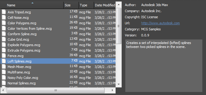

These fields along with the Category and the Version appear in the MCG package installation browser once the .maxtool has been packaged as a .mcg file.
When enabled, modifies the evaluation of the tool to ensure the timeline's playback is consistent with an internally cached simulation state. Also ensures that all caches in the tool are reset when the Reset Simulation button is pressed in the rollout, or if the timeline is set back to frame 0.
Note: For best results, if you are using a simulation tool in your scene, ensure the Real Time option is disabled in the 3ds Max Time Configuration dialog such that every frame is processed.
When disabled, removes the Open in MCG Editor button from the tool's rollout menu. If the tool is packaged, this button will not appear regardless of the option chosen.
The filepath and the dates at which the file was created and modified.
