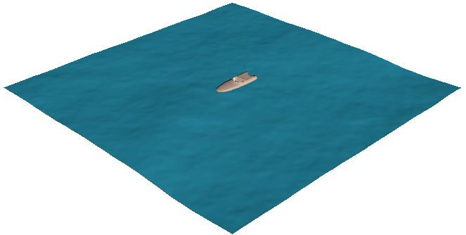

  10. Open the Content Browser. On the Examples tab, navigate to Modeling/Sculpting Base Meshes/Vehicles and import SportsBoat.ma.
  11. The boat mesh is too big for the scene, so scale it down by a factor between 0.01 and 0.02. You can delete the motor mesh.
  12. Animate the boat mesh to move from about –20 to +20 in the Z axis over 5 seconds (120 frames at 24 fps).
    For realistic results, you should use values that are close to real world velocities. In this case, an average speed of 8 m/s roughly corresponds to 16 knots, which is reasonable but not especially fast for a motorboat.
  13. Select the boat mesh, and then click in the Boss Ripple / Wave Solver window. For more information, see Add and edit BOSS influences.
  14. Play back again. You should see a wake behind the boat.
