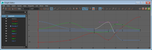

Weighted tangents
Weighted tangents: you can change angle and length
Weighted tangents have long handles that let you edit the influence and angle of the tangent quickly and intuitively, similar to Bezier-style behavior in vector-based graphics software. Weighted tangents let you manipulate both tangents on a key, keeping the arc of the curve balanced on both sides.

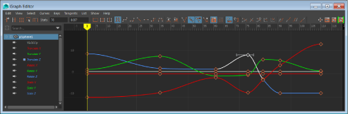

Non-weighted tangents
Non-weighted tangents: you can change angle but not length
Non-weighted tangents have simple handles that only control the tangent's angle.
