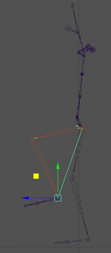

  7. In the side view, use the Move tool to drag the IK handle up and to the left (see following image), as if Jackie were stepping up a staircase. The foot and knee move while the hip stays in place.
  8. Set another key for the IK handle.

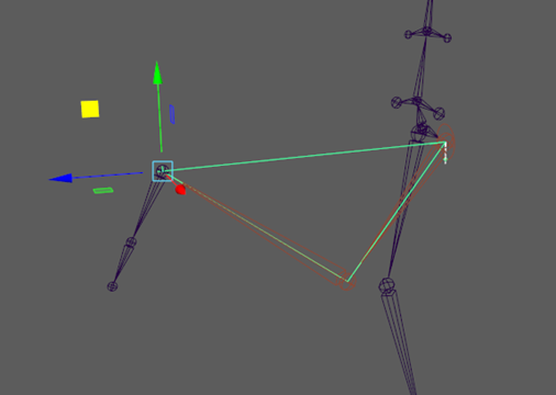

    As you drag the handle to some positions, you might notice the leg joints flip abruptly (see the next image for an example position). It’s therefore hard to control the leg positioning in this region.

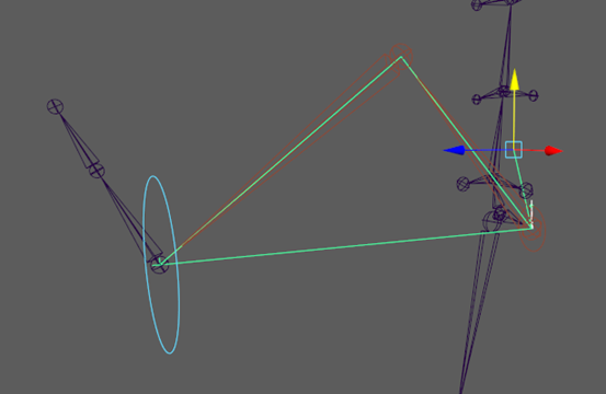

    The default IK handle (IK Rotate Plane handle) has manipulators you can use to avoid joint flipping. With the handle selected, select Modify > Transformation Tools > Show Manipulator Tool. Move the Pole Vector XYZ manipulator to a slightly different position (see the following image).
    If this doesn’t solve the problem, rotate the Twist manipulator to rotate the leg. You can key the Pole Vector XYZ and Twist attributes to fixed values to avoid the flipping as the character moves.
