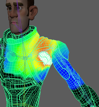

To modify skin weights using the Paint Skin Weights Tool
  1. Select left_arm_root in the Influences list.
  2. Set the Mode to Paint, then set the Paint Operation to Add.
  3. Set the Value to 0.1.
  4. Drag to paint on the irregular region of the underarm.
    As you stroke a region, a red circle icon indicates the area affected by the brush stroke. Each stroke adds 0.1 (10%) to the skin weight. The weight for a skin point has a maximum value of 1 (fully white).
    Tip:
    To change the size of the red circle icon, change the Radius(U) value in the Paint Skin Weights Tool.
    Repeat the strokes several times until the irregular region becomes smoother. The jagged, asymmetrical wireframe at the breast becomes more symmetrical as the skin becomes smoother. The region whitens, which indicates increased influence from the left_arm_root joint. Note that increasing the influence of one joint lessens the influence of the other influencing joints.
