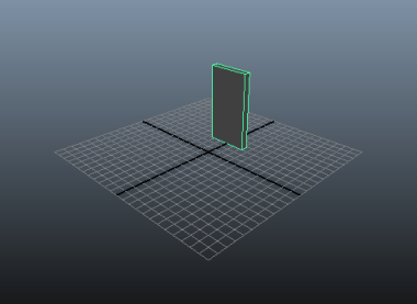

  4. Create a polygonal cube and name it Door.
  5. With the pointer in the perspective view, press 5 (for Shading > Smooth Shade All).
  6. Scale and position it roughly as shown. Have the bottom edge of the door lie roughly along the X-axis.

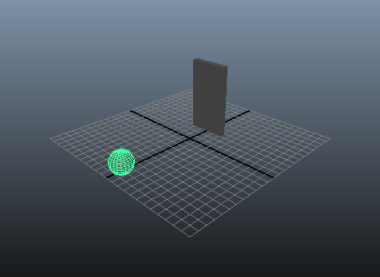

  7. Create a small polygonal sphere and name it Ball. Scale and position it roughly as shown in the prior figure in the introduction. Have it sit roughly at 0, 1, 10 (X, Y, Z).
