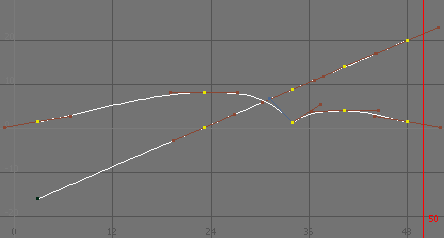

The ball seems to move too slowly in its journey. In the following steps, you’ll use the Graph Editor to hasten its movement. Specifically, you’ll cause the ball’s animation to finish its journey in two seconds (48 frames) rather than three (72 frames).
Tip:
Widen the Graph Editor window as necessary to see the graph clearly. Also, dolly the view or select View > Frame > Frame Selection (in the Graph Editor window).
To speed up the animation of the ball’s movement
  1. Drag a selection box around all key points of both curves.
  2. Select the Scale tool.
  3. Click and hold the middle mouse button anywhere in the graph at frame 1 (slightly to the right of 0).
    Notice the question mark icon. The location of this icon indicates the point from which scaling occurs. (Because you need to scale the animation inward toward frame 1, you need to start your drag operation at frame 1.)
  4. Without releasing the mouse button, drag to the left until the right-most key points on both curves are positioned roughly at frame 48. (When selected, the right-most key points are yellow.)
    Note: You can also use the Region Tool to scale your curves. Select the Region Tool from the Graph Editor toolbar, select the region of curves you want, then drag the region handles (white boxes) to scale.
    This scales the curves symmetrically towards frame 1. The animation of the ball now plays from frame 1 to 48 rather than 1 to 72. The ball traverses the scene in less time, which, of course, means it moves faster.
