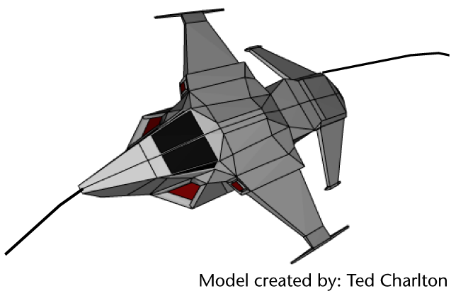

In this lesson, you make an aircraft follow a motion path so it appears to fly and bank while it changes trajectory.
