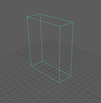

    A cube primitive in the shape of a rectangular box appears in the scene view.
    When the Create UVs option is on it ensures that the primitive object is created with a set of default UV texture coordinates. All polygon primitives in Maya provide an option for creating UV texture coordinates at the time of creation.
