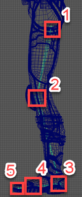

  3. In a side view, click at the hip, knee, ankle, ball of foot, and toe to create joints at these positions (see the following figure). Make sure the knee joint is in a position that creates a slight forward bend. The forward bend ensures that you will be able to animate the leg easily in a direction natural for a leg.
    Tip:
    Press +b (Windows) or +b (Mac OS X) to toggle between default background colors in the scene view.
  4. Press Enter (Windows and Linux) or Return (Mac OS X) after creating the toe joint. This completes the joint chain.

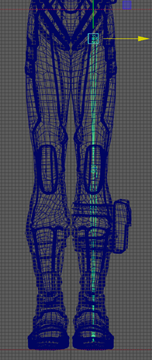

  6. Rename the joints as left_hip, left_knee, left_ankle, left_ball, and left_toe. To rename a joint, double-click the joint name in the Outliner. Type the new name and press Enter.

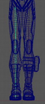

  7. In the front view, click the left_hip joint to select it. Move it along the X-axis to the center of the top of the left leg. (In this lesson, left and right refer to directions from Sven’s point of view, not from your view of the scene.)
    As mentioned before, when you move a joint, all joints lower in the hierarchy move with it. If you press Insert (Windows and Linux) or Home (Mac OS X) while a joint is selected, you can move the joint without moving joints below it in the hierarchy. (To exit this mode, press Insert or Home again.)
  8. To create the joints for the other leg, you can save time and ensure symmetry by duplicating the existing leg joint chain with mirroring. With left_hip selected, select Skeleton > Mirror Joints > . In the options window, turn on YZ for Mirror Across.
    Sven’s legs straddle the YZ plane, so mirroring the joint chain across the YZ plane positions the duplicate joint chain in the desired location. This operation illustrates that Sven’s original position affects the ease with which you can create the skeleton. Had Sven been positioned away from the origin, you would not have been able to use Mirror Joint to duplicate the leg’s joint chain.
  9. Enter left in the Search for field and enter right in the Replace with field.
    The Replacement names for duplicated joints feature automatically replaces the names of all duplicate joints with the specified joint prefix.
  10. Click Mirror.
    The right leg bones and joints appear in a mirrored position.

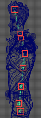

  1. In the side view, use the Joint Tool from the Rigging shelf as follows to create a series of joints at the locations shown in the following figure:
    • Start at the base of the spine near the existing hip joints (left_hip and right_hip) and end at the top of the head.
    • Make sure you create the first joint a little bit away from the existing hip joint displayed in the front view, otherwise the first joint will be connected to the hip joint.
    • Press Enter (Windows and Linux) or Return (Mac OS X) when you are finished creating the joint chain.
    With the exception of the joints at each end of the joint chain, the joints are located where the character is likely to bend or twist at the spine and neck.
    The S-shaped curvature of the joint chain resembles Sven’s spinal curvature. This makes it easier to animate the character’s torso and neck naturally.
  2. In the Outliner, starting at the base of the spine, name the joints back_root, pelvis, lower_back, mid_back, upper_back, lower_neck, upper_neck, and crown.

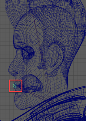

  3. To set up the skeleton for jaw movement, extend a joint from the upper_neck joint as follows:
    • Select the Joint Tool, and click the upper_neck joint in the Outliner to select it.
    • In the scene view, click to create a new joint near the lips, and press Enter or Return.
    • Name the new joint as jaw.

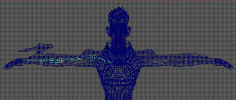

To create joints for the arms

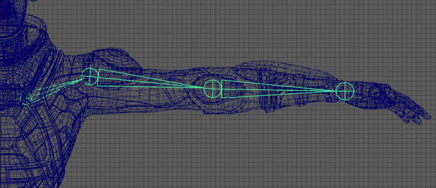

  1. In the front view, create a series of joints at the locations shown in the following figure. Start at the pectoral region (near the upper_back joint) and end at the wrist.
  2. Name the joints left_arm_root, left_shoulder, left_elbow, and left_wrist.

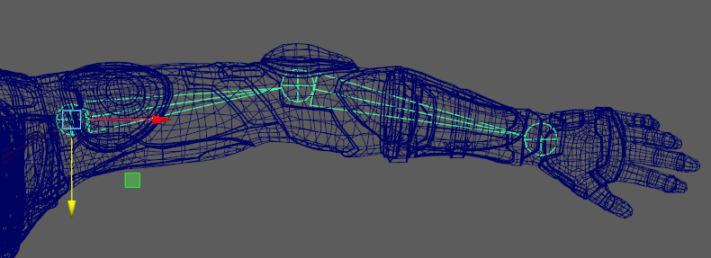

  3. In the top view, adjust the joints to match the arm's shape. Select the Move tool, press Insert (Windows and Linux) or Home (Mac OS X), then move the joints individually to their correct positions. Press Insert or Home again.
    Moving the joint to the back of the arm creates a bend at the elbow. This will make it easier to animate the character’s arm in the direction an arm naturally bends.
  4. In the perspective view, select left_arm_root. Select Skeleton > Mirror Joint. This creates a copy of the left arm’s joint chain for the right arm and renames them in the process.
    The right arm bones and joints appear in a mirrored position.
