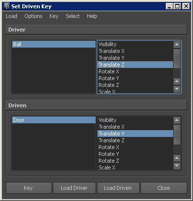

The following steps link the door’s movement to the ball’s movement using Set Driven Key.
To link the door’s movement to the ball’s movement
The Set Driven Key window appears with the door in the Driven list.
This is the attribute to be driven by the ball’s movement.
The ball appears in the Driver list.
This is the attribute that will drive the door’s movement.
You can set a driven key only after you select an attribute in the Driver list and in the Driven list.
This sets a driven key relationship that links the current Translate Z value of the ball to the current Translate Y value of the door. Whenever the ball’s Translate Z is at this position, the door’s Translate Y will be at its current position.

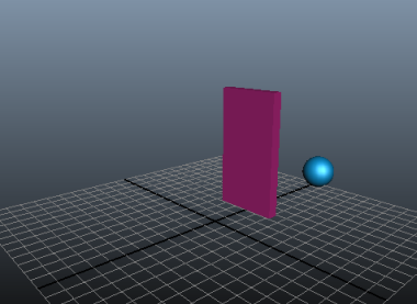

The objects in these images have materials applied to give them color. Try Lesson 2: Shading surfaces in the Rendering chapter of the Getting Started guide to learn how to apply materials.
This sets another driven key that links the current Translate Z value of the ball to the Translate Y value of the door.
This sets another driven key that links the attributes.

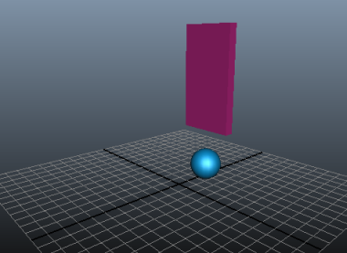

You’ve set three driven keys that link the attribute values at different positions. Maya interpolates the linked values to generate the values between the keys.
If you drag the ball toward the door from either side, the door rises smoothly.
