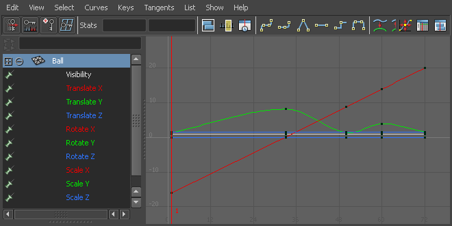

  1. With the ball selected, select Windows > Animation Editors > Graph Editor.
    The Graph Editor displays several animation curves, one for each keyed attribute of the ball. The animatable attributes for the ball are listed in the left column. Specifically, it displays the attributes of the selected transform node of the ball.
    Each curve graphs how an attribute changes value during the animation. The column of numbers at the left represents attribute values that can be animated, while the row of numbers at the bottom represents time (frame) values. At each point on the curve, you can see the value of an attribute at a particular time. The small black squares on the curves represent points where you’ve set keys.
  2. Shift-Select only the Translate X and Translate Y attributes in the left column of the Graph Editor.
    Now only the animation curves for Translate X and Translate Y appear in the Graph Editor.
    This simplifies the display. With too many curves present, it’s hard to see specific curves. When you use the Graph Editor, you usually focus on one or a few curves.

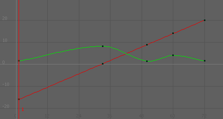

  3. To center the display of the animation curves, select View > Frame > Frame Selection (in the Graph Editor window). If you want to see more detail in the graph, use your mouse to dolly and track the graph view.
    The green curve represents Translate Y, while the red represents Translate X. The color of each curve matches its attribute name. This color scheme is consistent throughout Maya for X, Y, and Z (red, green, blue).
    If you’ve never used a graph editor before, the relationship between a curve’s shape and the animation it represents might be hard to understand. With experience, you’ll quickly recognize how curve shape affects animation.
    In the above graph, the straight curve of Translate X indicates that the ball moves horizontally across the ground at a constant rate over time.
    The wavy curve of Translate Y indicates that the ball increases its height steadily until frame 33, dips more quickly until frame 50, then rises and dips again until frame 72.
    When the ball first bounces off the ground at frame 50, it seems to float and slip rather than rebound. The shape of the Translate Y curve illustrates why. Near frame 60, the curve is soft and rounded. The Translate Y values gradually decrease to the low point then gradually increase. The transition from decreasing to increasing values is smooth.

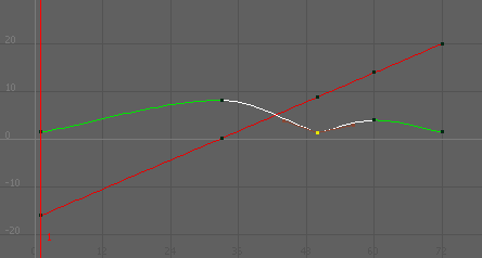

  4. Select the point on the Translate Y (green) curve at frame 50.
    This causes a pair of tangent handles to appear at the point. Each end point of the newly displayed straight line is a tangent handle. The handles let you control the curvature near the key point.

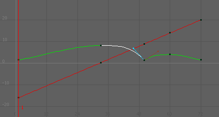

  7. Select one of the tangent handles.
  8. Select the Move Tool and then use the middle mouse button to drag the tangent handle upwards a little so you can see the how the curvature at the key point changes.
    By default, when a pair of tangent handles share a key point, they work as a unit. Move one and you move the other in an opposing direction. This is often desirable in an animation curve, because it ensures the curvature at that point stays symmetrical. Symmetrical curvature often helps prevent unusual animation shifts.
    In this case, however, you want to steepen the curvature’s approach toward the curve point in the same direction on both sides. You therefore need to break the symmetrical interdependency between the two tangents.
  9. Undo your previous move of the tangent handle.
  10. Select the key point at frame 50 (not a tangent handle).
  11. In the Graph Editor, select Tangents > Break Tangents.
    This lets you move each tangent handle independently.
  12. Select the right tangent handle and use the Move Tool to move it up a little. Do the same for the left tangent handle. Be careful not to select the key point.
    This sharpens the bounce to better simulate the effect of gravity and elasticity.
