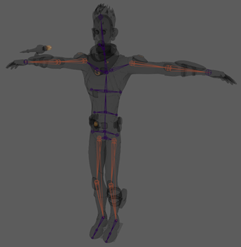

In this lesson, you will load a scene containing a human character and skeleton. Each leg and arm of the skeleton has an IK handle that lets you pose the limbs conveniently. If you completed the prior lesson, the character, skeleton, and IK handles will be familiar.

  2. Open the scene file named SmoothSkin.mb.
    This file can be found in the GettingStarted2020LessonData\CharSetup directory that you set as your Maya project.
    The character in the scene, Sven, is displayed in a transparent fashion so you can see the skeleton beneath the surface.
