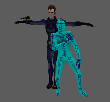

This loads the Dummy_Fight character into your scene.
- Close the
Visor window and zoom out in the workspace (if necessary) until you can see the Dummy_Fight character in the scene.
- Select
> Rename Character and rename the character as
FightSource.
- Open the
Definition tab and note that the FightSource character already has a valid skeleton definition.

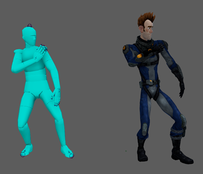

The target character snaps to match the position of the source character, and retargeting controls appear in the
Controls tab.
To see the retargeted result clearly, Character1 needs to be offset from FightSource.
- With Character1 selected as the current character, click the Reference cell in the Definition tab.
- Use the move tool to move the model so that the two characters are separated.
- Play back the animation to view the retargeting result.
