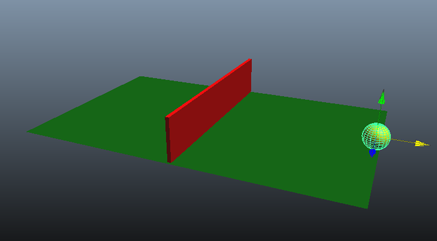

  3. Go to frame 72. A convenient way to do this is to click the desired position in the Time Slider.
  4. With the Move Tool, drag the ball’s X-axis handle to position the ball at the right edge of the ground as shown in the image below.
  5. Set a key at frame 72. (Press s.)

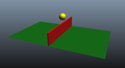

To make the ball fly over the fence rather than pass through it, you need to position the ball above the fence and set a key there.
To set intermediate keyframes
  1. Go to frame 33 or so—at the moment where the ball sits in the middle of the fence.
  2. With the Move tool, drag the Y-axis handle of the ball until it sits slightly above the fence.
    Tip:
    Throughout this lesson, tumble the perspective view or examine a front view to make sure the positioning is correct.
  3. Set a key. (Press s.)
  4. Play the animation.
    The ball now flies off the ground, over the fence, and back to the ground in a smooth arc between the keyed start, middle, and end positions.

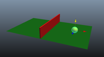

  1. Go to frame 50. At this moment, the ball sits in a position above the middle section of the right half of the ground.
  2. Move the ball so it sits on the ground.
  3. Set a key.

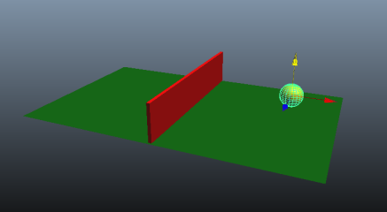

  4. Go to frame 60.
  5. Move the ball up again, but not as high as its peak height above the fence.
  6. Set a key. When you play the animation, the ball travels over the fence and bounces on the other side.
