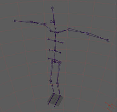

    Now if you need to move the entire skeleton, you can move back_root—the root of the hierarchy. The completed skeleton is shown in the following figure (with Sven hidden).
