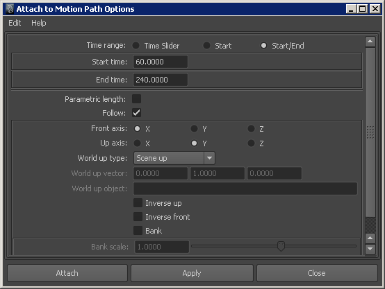

  3. In the main menu, select Constrain > Motion Paths > Attach to Motion Path > .
    The Attach to Motion Path Options window appears.
  4. In the options window, ensure the options are set as follows, then click Attach:
    • Time Range: Start/End
    • Start time: 60
    • End time: 240
    • Follow: On
    • Front Axis: X
    • Up Axis: Y
    • World up type: Scene up
    • Leave all other settings off
  5. Click Attach.

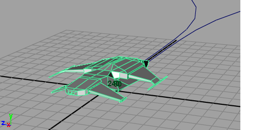

    The aircraft is repositioned to the start of the curve, and oriented towards the direction of travel.
    The Start and End times set the time duration the aircraft travels along the path curve (240 - 60 = 180 frames). The start and end times are displayed at the ends of the curve.

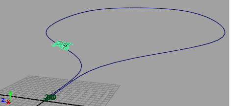

  6. Click play on the Time Slider playback controls to play back the animation.
    The aircraft travels along the path. Observe that it begins its motion at frame 60.
