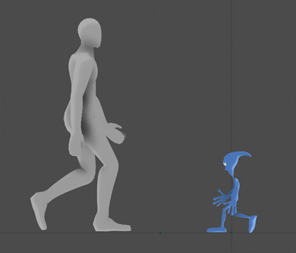

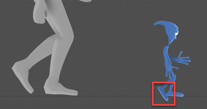

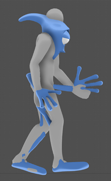

    By default, the target character (Pepe) is acting in its own action space (where the character performs motion), which automatically compensates for the scale difference between the source and target characters. However, in this example, the retargeting does not take into account that Pepe's foot proportions are also different. Since his feet are longer than WalkExample's feet, the retargeting result is affected. For example, at frame 1 Pepe's right foot penetrates the ground and his stride is very short.

  4. Turn Match Source On.
    When turned on, this property makes the target character act in the source character's action space, enabling you to reach the IK Blend goals of the source.
    By default, the IK Blends (IK Blend T and IK Blend R) on Pepe's hips and feet are set to 1.00, which inidcates that these body parts are reaching toward WalkExample's body parts.
    As a result, the hips and feet reach to match the position of WalkExample.
    However, when Pepe's feet are placed in the same positions as WalkExample, his stride looks over-exaggerated and unrealistic.

To achieve a realistic stride for Pepe

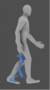

  1. In the HIKproperties1 tab, set Action Space Comp Mode to User.
    This attribute lets you set an exact value to determine how retargeting is scaled to compensate for different sizes in your source and target characters.
    Note: When Action Space Compensation has a value of 0.000, the target character (Pepe) is immobile and disappears from the scene.
  2. Enter 10.000 into the Action Space Compensation field.
    Maya applies this value as a percentage to the size of all movements carried out by the source character when determining positions for the target character. The higher the value, the longer the character's stride. The smaller the value, the smaller the stride.
  3. Playback the animation.
    Since the Action Space Compensation value is low, Pepe's stride is still very short.
  4. Change the Action Space Compensation value to 48.000.
  5. Playback the animation.
    Pepe's stride is significantly longer when we apply a User defined value instead of keeping the default Auto setting. We can see this improvement at frame 54:
    Setting only this attribute gives us a good retargeting result. Now that we've fixed the stride, we can look at other properties that can help us achieve a good retargeting result.

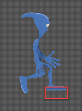

  2. Set Ankle Height Comp mode to User.
    By default, Auto mode ensures the feet relate correctly to the floor. When set to Off, ankle height compensation is disabled. When set to User, you can adjust the distance between the model's feet and the floor manually by setting the Ankle Height Compensation value.
  3. Set the Ankle Height Compensation value to 5.000.
    This value adjusts the distance between the character's foot and the floor. This value is often adjusted when your character has special height requirements (for example, shoes with high heels or boots) or your character's feet are very large.

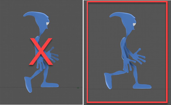

Mirror Animation
When turned on, the target character mirrors the movements of the source character. The solver flips the position of each of the source character's nodes along the X-axis to determine the desired position of the corresponding node of the target character. In the following example Mirror Animation is on and Pepe mirrors the actions of WalkAnimation.

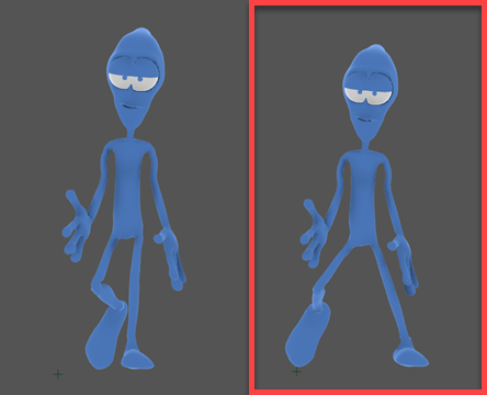

Feet Spacing Mode
By default, Auto mode adjusts the distance between your target character's left and right ankles. The solver adds its value to the spacing between the source character's left and right ankles in order to determine the spacing between the target character's left and right ankles. When set to Off, no adjustment occurs. When set to User, you can enter a specific Feet Spacing value to adjust the ankles. In the following example Feet Spacing is set to a value of 8.000 in the version highlighted in red. The one of the left is in Auto mode.
