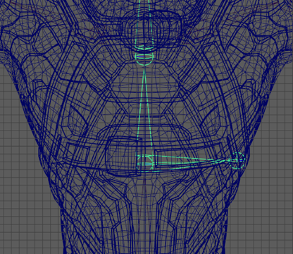

  1. In the Outliner, click the mid_back joint to highlight the joint in the front view. Remember the location of the joint in the front view so you can select it later.
  2. In the Rigging shelf, select Joint Tool.
  3. In the front view, click on the mid_back joint to select it again.
  4. Click to the side of the joint to add a rib bone, then press Enter (Windows and Linux) or Return (Mac OS X).

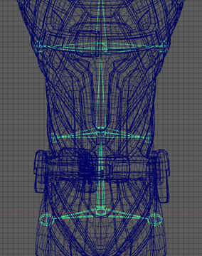

  5. With the same technique as in the prior steps, create two more ribs for the left side. The ribs extend from the mid_back, lower_back, and pelvis joints.
  6. For easy identification in the Outliner, you can optionally name the ribs as desired. For instance, name them left_top_rib, left_mid_rib, left_bottom_rib, and so on.
  7. Mirror each of the left rib joints to create ribs for the right side of the skeleton.
