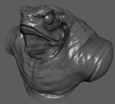

To open the high resolution model
  1. Select File > Open Scene.
  2. Navigate to GettingStarted2020LessonData\UVMapping, select Toad_hi_res.mb and click Open.
    A high resolution polygonal toad model appears in the scene.
  3. Tumble the view around the toad model.
    Maya may respond slowly because the mesh is highly detailed. You can see exactly how detailed it is by turning on the Poly Count display.
To turn on the Poly Count display
  1. Select Display > Heads Up Display > Poly Count.
Statistics about the scene appear in the top left corner of the main viewport. This model consists of over two million faces just for the head and upper torso. Loading such a high resolution model into the scene is impractical for performance purposes.

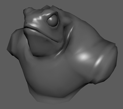

To import the low resolution model
  1. Select File > Import.
  2. Navigate to GettingStarted2020LessonData\UVMapping, select Toad_lo_res.mb, and click Import.
    A low resolution polygon model loads on top of the high resolution toad model.
  3. Select the high resolution model and hide it by pressing + h.
The low resolution model is much more manageable in size with just over 1500 faces. However, while it maintains the basic shape of the high resolution toad, it lacks much of the detail.
