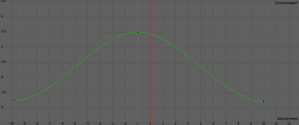

  3. From the Graph Editor, select View > Frame > Frame All. The Graph Editor shows the driven keys that link the door’s Translate Y value to the ball’s Translate Z value. An example follows:
    The column of numbers on the left lists the driven attribute values. The row at the bottom lists driver attribute values. The animation curve shows the relationship between the values—the door’s Translate Y value rises as the ball’s Translate Z value approaches 0.
    You can use the Graph Editor to edit the shape of the curve to make the door rise faster, slower, and higher as the ball approaches it.
