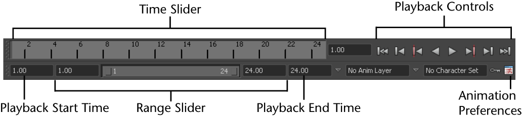

  1. Look over the playback controls, as shown in the figure below:
    The Time Slider displays the playback range and keys you’ve set for a selected object. Keys are displayed as red lines. The box at the right of the Time Slider lets you set the current frame (time) of the animation.
    The Playback Controls control animation playback. You may recognize the conventional buttons for play and rewind (return to the start time). The stop button appears only when the animation is playing. To find out which operation a button represents, hold the mouse pointer over it.
    The Animation Preferences button displays a window for setting animation preference settings such as the playback speed.
    The Range Slider controls the range of frames that play when you click the play button.
    The above items will have more relevance as you work through this lesson. After you complete this lesson, experiment with these items to learn more what they do.
