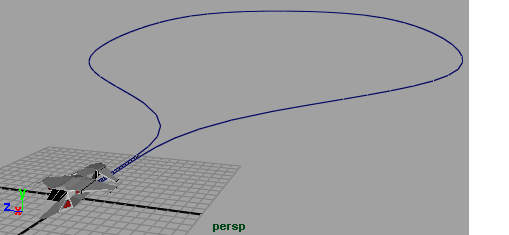

    The scene contains two objects named Aircraft and PathCurve. When the aircraft travels on the path curve it will return to where it began.
  3. In the Time Slider, ensure that the Playback End Time is set to 240.
The path animation occurs between frames 60 and 240 (180 frames in total). Between frames 1 and 60, you keyframe the aircraft’s motion so it rises from the ground plane. You then blend between the two animation types.
