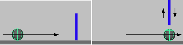

In this lesson, you will learn how to use Set Driven Key in order to animate a door rising upwards when a ball approaches it.
