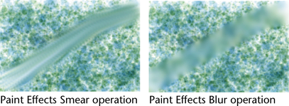

Smearing with a Paint EffectsSmear brush blends adjacent colors together along the stroke path.
Blurring with a Paint EffectsBlur brush softens the edges of adjacent colors by averaging their color values.
You can use the default Paint EffectsSmear or Blur brushes or select any Paint Effects brush with a Brush Type set to Smear or Blur. To select the default Smear or Blur brushes, click Reset Brushes and in the Paint Operations section, select Paint EffectsSmear or Blur, as appropriate. Use the Blur Intensity option to adjust the blur effect.
