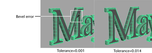

The Attribute Editor’s illustratorforBevel tab includes a Tolerance attribute that can help fixing beveling problems. In an imported Adobe Illustrator file, if a curve is next to a line, the line point may be in a slightly different position than its neighbors. This can cause bevel errors where the bevel extends into space away from the main curve.
Possible solutions include:
If you use Tolerance, CVs may be snapped together. This can cause edges with zero length, which can be removed with the Poly Cleanup Tool.
