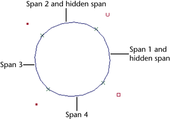

For example, suppose you create a circle primitive with four spans (sections). A circle primitive is a periodic curve. If you display the circle’s edit points, you’ll see only four spans. There are actually six spans, but the last two overlap the first two.
