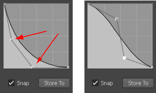

To adjust the shape of the falloff curve
next to the falloff curve image to open a larger
Falloff Curve editing window.
at the bottom of the curve view, or Ctrl-click points directly. (The cursor displays with a red x
when deleting points.)
To help you distinguish between points that are close together on the curve, the delete handles display in shades of grey. The darker the delete handle, the higher the point on the Y-axis.
