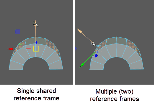

When moving, rotating, or scaling components, you can choose to transform them all relative to a single shared reference point, or along multiple reference frames based on which components are selected.

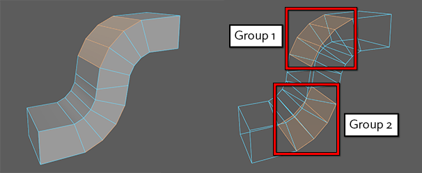

Component groups refer to any sets of adjacent components within the current selection.

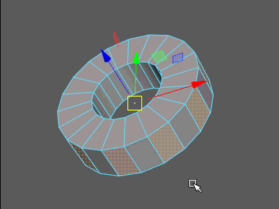

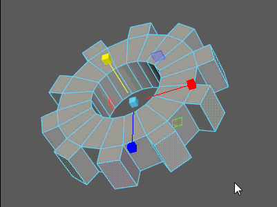

Setting Axis Orientation to Component transforms each group according to its own reference frame. The reference frame for each group is the average of all components within that group.
However, one exception is when Ctrl + middle-dragging with the Move Tool. This translates each component along its own reference frame, ignoring their group.
While using the Move, Rotate, or Scale Tool, you can temporarily activate Component mode by Ctrl + middle-dragging. This works with any Axis Orientation currently active, except Normal, and will constrain the movement differently depending on which tool is active.

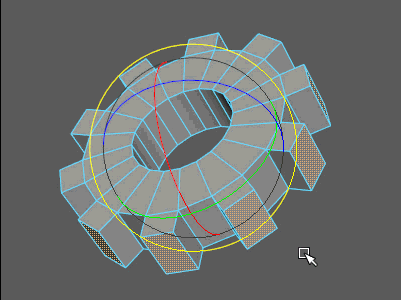

Ctrl + middle-dragging with the Rotate Tool rotates each component group along its local X axis. |

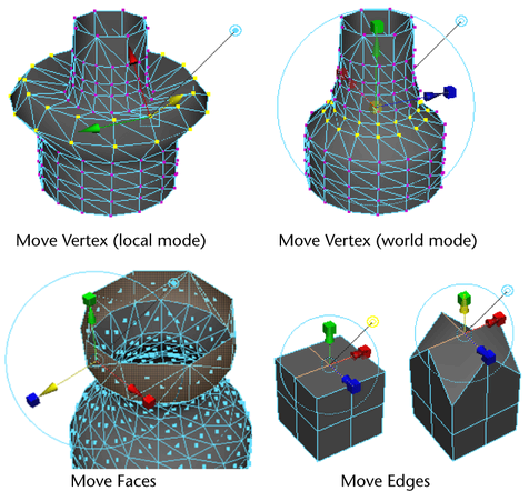

In addition to the methods above, you can also move components with history. This method allows you to modify the history node associated with it, but also has more limitations when it comes to working with other features like symmetry.
To create a history node to transform components
Maya creates a transformation node (polyMoveComponentType) and automatically switches to the Show Manipulator tool, allowing you to edit the node.

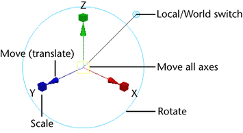

The manipulator is a standard move/rotate/scale combined manipulator, with an extra handle to switch between Local axes and World axes. Moving components along their local Y can be very useful to move components “inward” or “outward”.
