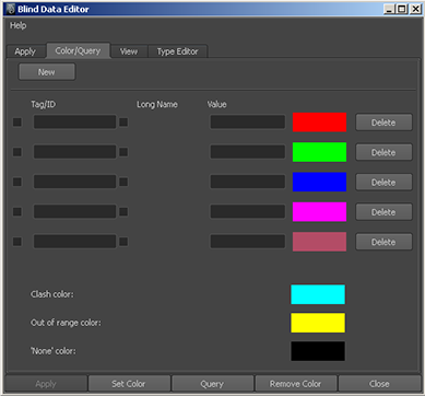

Use this tab to false color and query polygonal objects and components based on criteria you set up. There are several levels through which you can look at the data.
The first is a high level view of what components or objects have the specified blind data assigned to them, regardless of value.
The colors show the sequence of queries that were performed, and do not get updated by subsequent changes to blind data. If the object’s topology changes, colors may no longer be accurate.
To complete the Tag/Id fields, right-click in the field to bring up a popup of the available types, or type in the fields.
In the following illustration, Set Color goes through the selection list and colors components that have floorType blind data red, wallType blind data green, and ceilingType blind data blue. If any components have two or more of the specified types assigned, the components (or objects) are colored with the Clash Color, in this case, light blue. Components that have none of the specified types are colored with the None color, which is black in this case.
Click Query to select the components (or objects) which would be colored if you had chosen Set Color. Note that if any of the row conditions are satisfied, the component or object is selected.
To use a row in the Color/Query operation, turn on the check box to the left of the Tag/Id field. Disabling a row is useful if you do not want to use a particular type or value but may want it later.
Click Remove Color to remove color from the components that have the listed blind data types.

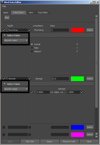

When you enable the values for a row, this section displays below the row, providing you with the following options for the color or query action.
Select this option to color or query one value for a particular type.
Select this option to color or query a range of values for a particular type.
In the following illustration, components with the blind data type floorType with a value of 0 (corresponding to preset: normal) are colored red. Components with blind data type damage and values between 75 and 100 are colored green. Components with both floorType and damage blind data are colored with the Clash color.

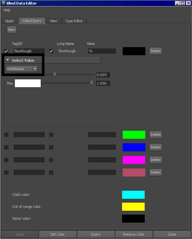

Integer or double data can also be colored with grayscale values. Select continuous from the drop down menu, and select min and max values and colors to use in coloring the data.
In the following illustration, the blind data type floorRough is displayed. Components which have a value of 0 are colored black, those with values of 1 are colored white, and those in between will have the appropriate grayscale. Values less than 0 or greater than 1 are colored yellow, the Out of Range color. The None color is blue to differentiate between components with 0 floorRough and components that have no floorRough assigned at all.
When using the continuous type, query works as if discrete range were selected; any components that have blind data with values between the min value and the max values are added to the selection list.
The Blind Data Editor will not properly handle false coloring and querying of more than one blind data type with the Continuous type enabled. The Blind Data Editor also will not handle combinations of Discrete Value colors/queries (including unsigned color/query actions) and Discrete Range colors/queries - if a specific value is required in combination with a range, use that value for both the Min and Max in the discrete range section.

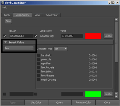

You can also color and query with the hex type if the blind data type selected consists of hex data.
When the selected Compare Type is Set, components with the selected value(s) set are colored or selected. If it is Not Set, only components with the value not set are colored or selected. If set to Equal, only values which equal the selected value are colored or selected.
