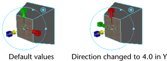

Enter a value to set the location of the X, Y, or Z-point in the local axis. Notice how the manipulator handles change accordingly when you change the Y direction value to 4.0.

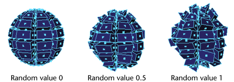

Enter a value to duplicate faces in random directions, with a value of 0 to 1. Lower values are closer to the specified direction. Higher values are more randomized.
In the following example, faces were extruded with random values of 0, 0.5, and 1.
