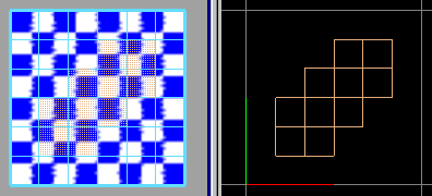

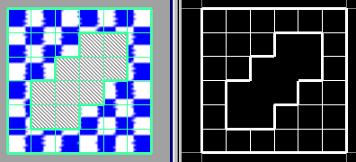

To delete UV texture coordinates for a selected face
The UVs associated with the selected face(s) are deleted.
Because the selected faces have no UVs, textures cannot be applied to them until UVs are re-created.
When you select one UV in the UV Editor and select Edit > Delete, all of the UVs for the face(s) associated with the UV you selected also get deleted. For this reason, the Delete key on the keyboard does not delete UVs because of the unique requirements of this operation.
