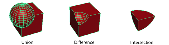

Maya performs the boolean operation. The faces of the objects are now connected and the original meshes act as one single object. The new object is named after the first selected object and increments by 1. For example, if you select pSphere1 and combine it with pCube1, the combined mesh will be named pSphere2.
For example, you can subtract a sphere from a cube using the Difference operation, and then animate the original sphere to create an interesting effect.
