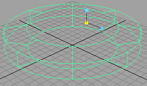

Use to create an extruded surface with a beveled edge from any curve, including text curves and trim edges. For example, to create a ledge on a building, or the rolled edges on an upholstered chair.
Create a simple extrude and bevel

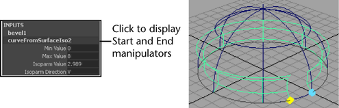

You can create beveled surfaces from normal 3D curves, isoparms, and surface edges.
If you turned on the Partial option in the Bevel Options window, click the curve or isoparm heading in the channel box to show additional attributes for using only a subsection of the curve.

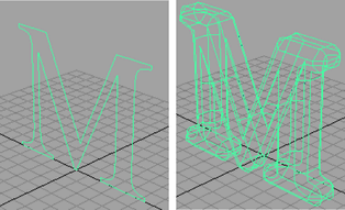

Bevel Plus has various features beyond the Surfaces > Bevel operation:
Bevel Plus is useful for creating solid letters and logos.
