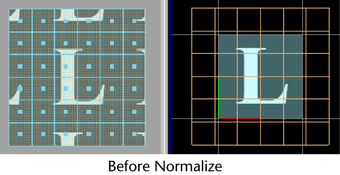

Use these options to set what happens when you select .

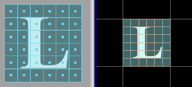

Select Collectively to normalize the UVs for all selected faces collectively. That means the texture coordinates for all selected faces are “collectively” fit to the 0 to 1 texture space. This is the default.

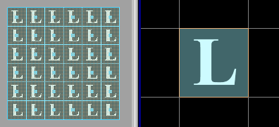

Select Each face separately to normalize the UVs for each selected face separately. That means the texture coordinates for each selected face are fit to a boundary of 0 to 1.
