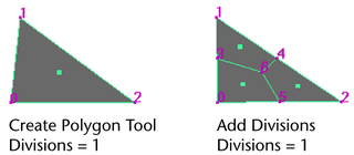

Specifies the number of Divisions that are distributed along the edges of the polygon being created. The default is 1. Extra vertices are created along the edges. You can manipulate these vertices in subsequent operations.

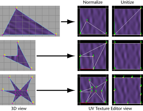

When Normalize is selected, the texture coordinates are scaled to fit into the 0 to 1 range of the UV texture space, maintaining the original shape of the UV face.
When Unitize is selected, the texture coordinates are placed on the corners and boundary of the 0 to 1 texture space. A polygon with three vertices will have a triangular UV texture map (with sides of equal length), while a polygon with more than three vertices will have a square UV texture map.
