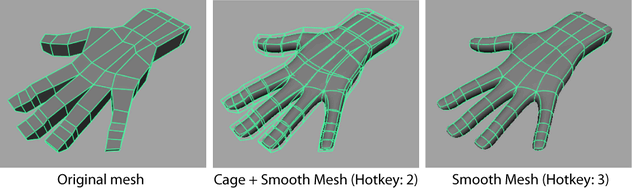

Smooth Mesh Preview lets you quickly and easily see how your polygonal mesh will appear when smoothed. You can quickly cycle between different Smooth mesh preview modes by pressing the 1, 2, or 3 keys when an object is selected.
By default, meshes automatically display with Smooth Mesh Preview turned off. When Smooth Mesh Preview is turned on, you can display the original mesh and a smoothed preview simultaneously (Cage + Smooth Mesh display mode) or the smoothed preview by itself (Smooth Mesh display mode).
This mode is ideal for tweaking your mesh prior to an actual smooth mesh operation since any modifications you make to the original mesh will automatically update the smoothed preview. However, remember that Smooth Mesh Preview only changes the display of a mesh to allow you to visualize how it will appear when smoothed. The original mesh is not modified or smoothed.
