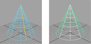

In the following figure, a V isoparm is selected, moved, then detached twice. The first detachment moves the seam of the cone, which is periodic in V.
