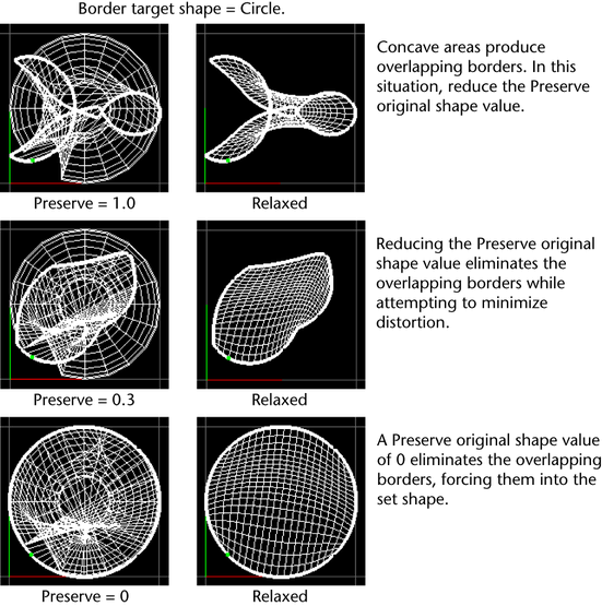

Determines how closely the border mapping will match the selected Border Target Shape. Use the slider or enter a value between 0 and 1 to control the blend of the existing UV border with the specified Border Target Shape. A value of 0 produces a UV border mapping that is closest to the specified target shape (Square or Circle). A value of 1 produces a border that closely represents the world-space relationships between edges, but can result in concave areas along the border—these will produce overlapping interior UVs once relaxed.
