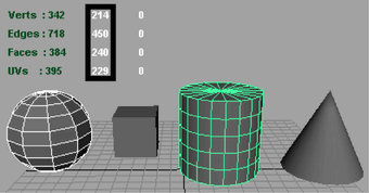

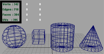

| Column | Shows... |
Left |
Total counts for all visible polygons. ![]() |
Middle |
Counts for selected polygons. ![]() |

The Poly Count display only counts visible objects (whether they are selected or not). If you track the view so some objects are no longer visible, they will not be included in the polygon count.
