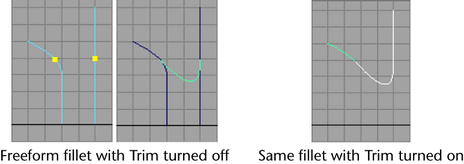

Keeps only the parts of the original curves that flow toward the fillet curve ends. Other parts are deleted.

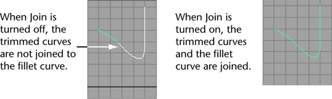

Joins the trimmed curves to the fillet curve, thereby creating a single curve. Available only when Trim is on.

Freeform creates a curve that’s determined by the curve points you selected before the Curve Fillet operation.
