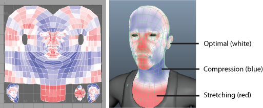

The distortion shader lets you easily pinpoint UVs that are stretched or compressed. Color feedback lets you visualize distortion errors: red faces indicate stretching, blue faces indicate compression, and white faces indicate optimal UVs.
To identify UV distortion

Areas of distortion are shaded relative to the texture area in UV space.
