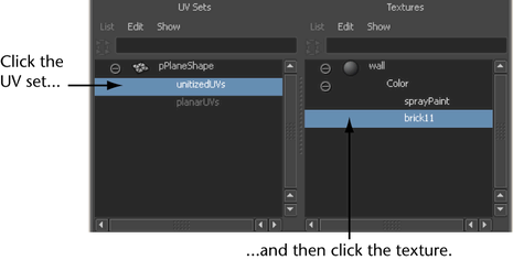

You assign textures to UV sets using the Relationship Editor.
Select Windows > Relationship Editors > UV Linking > UV-Centric to open the Relationship Editor’s UV set editing view.
| To... | Do this |
Assign a texture to a UV set. |
Click the UV Set in the left column, then click the texture in the right column so it’s highlighted. |
Remove a texture from a UV set. |
Click the UV Set in the left column, then click the texture in the right column so it’s not highlighted. |

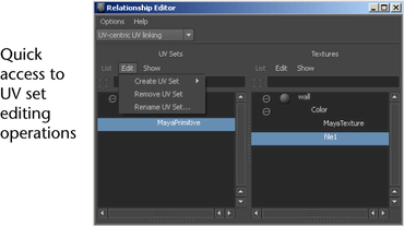

The Relationship Editor also provides easy access to several of the UV set editing operations in its Edit menu.
