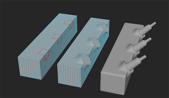

Use these options to set what happens when you select .
(Available in the in-view editor) Determines which set of components normals (face or edge loops) are averaged to orient the circle.
Adjusts the initial extrusion amount based on the average normal of all selected components.
Determines how much rotation is applied to the components around the center of the circle.
Adjusts the spacing between components so that they stay within the circle while remaining evenly spaced. Lower values will enforce the components' original spacing.
Specifies whether or not the inserted edges on the circle are automatically softened or hardened when the operation is complete.
Specifies whether or not circularized vertices are evenly distributed along the circle's circumference.
Adds additional vertices to the current selection, which results in smoother circles.
Adds edges to the vertices along the circle's circumference. This can be used to help avoid n-gons from either the outside, inside, or both sides of the circle.
