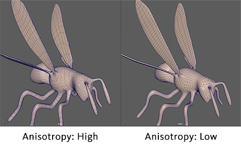

Determines how much the faces on the result mesh are allowed to squash or stretch to fit the source surface shape. Lower values produce varying sizes of quads that adhere more accurately to the original mesh curvature, while higher values produce more regularly sized quads.
